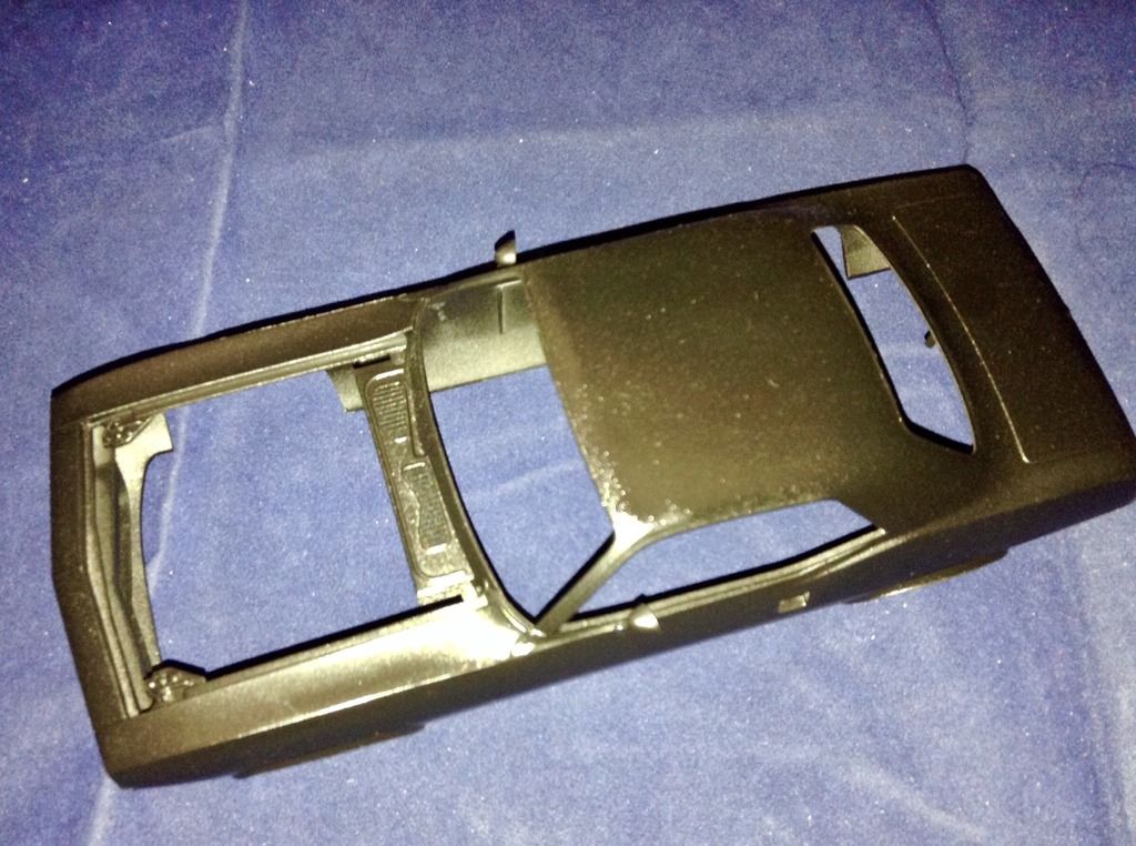

Posted: Tuesday, March 05, 2019 - 03:01 AM UTC

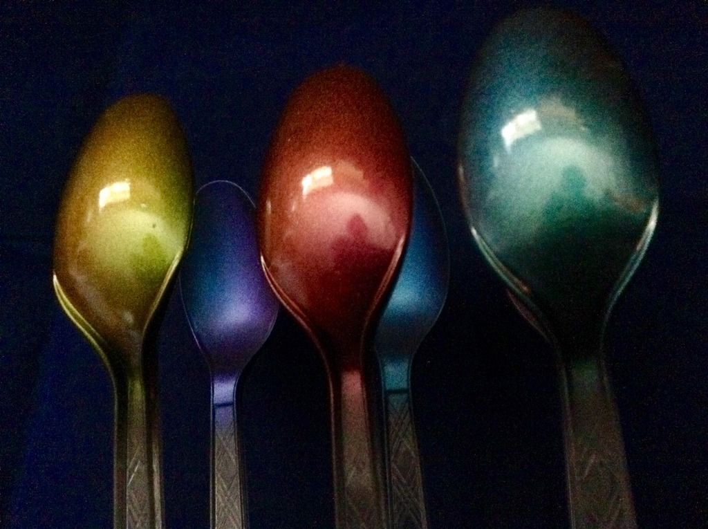

Well thanks for the talk on colours and as you’ll see in this post colour is something I’ve been looking at.
Any ways here is the Cuda all in black gloss primer about to get sanded
Now talking of colour, I was looking for some pearl finish paints for the upper sides / top of this custom job, lower sides will be ‘shine silver’ when I found these paints, intriguing I thought so I ordered two sets (1 & 3)
Colorshift metal waterbased acrylic paint from Green Stuff World in Spain
Set 1 content
Set 3 content

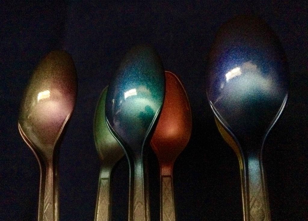

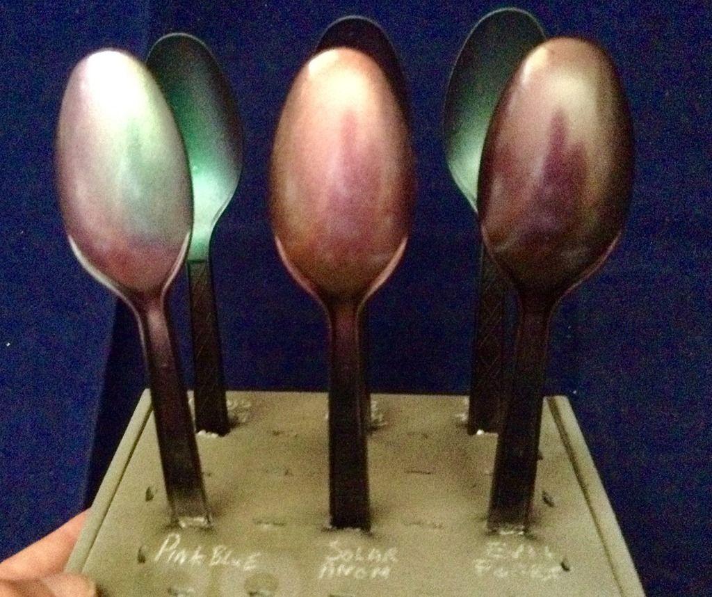

Spoon test only carried out with set 3 as I didn’t have enough spoons to do both sets. I’ll do set 1 Friday if you’re all interested.
Gloss black primer
Paint
Vallejo gloss varnish
The paint dries with a matt finish which can be seen on the inside of the spoons and the effect is more visible on the matt finish but except for my poor lighting the finish is still nice with the gloss coat in person.
Now which paint to use?

I have contemplated buying some of these Green stuff colors myself. Will be very interesting to see the result.
Lot's of colors to choose from. If the choice was by name only, I would go for "Darth blue" or "psychotic illusions"

Luciano
I've never heard of those paints before, but the colors are amazing. Which ever one you decide on should be a show stopped for sure.

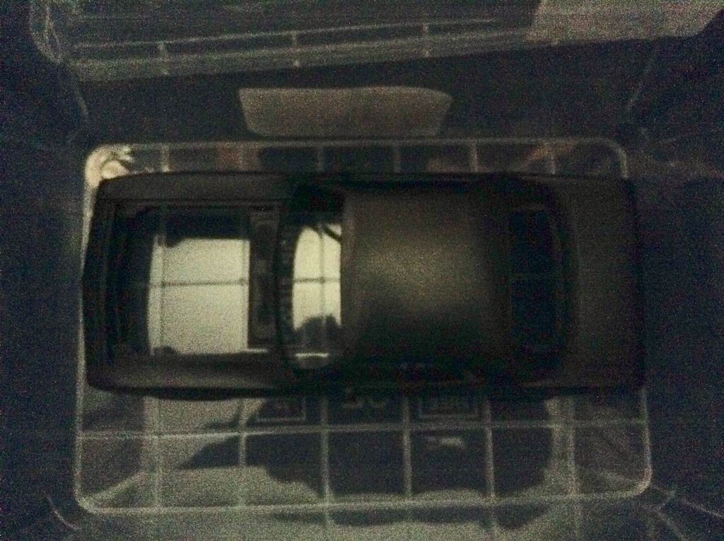

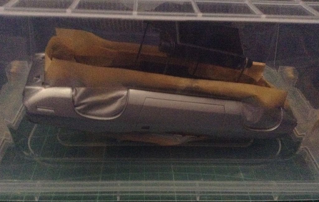

Not much to show and with the light fading fast I didn’t get around to painting spoons with set one today.
However the Firebird has had a coat of primer and the ‘Cuda has had the gloss black base coat polished to get rid of the imperfections one of which turned out to be plastic not paint! So next step is black base again where I had to sand and polish the plastic down.
So a photo of the body in its little garage. I picked up a couple of these cheap plastic food containers on the bay just for use with the cars. The containers are big enough for the car to sit on the lid and the box to be put over the top to keep any dust off while the paint drys.
Like I said not much to see but progress is progress.

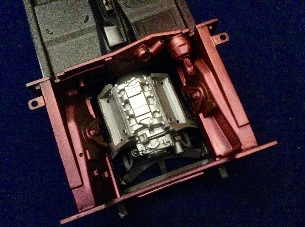

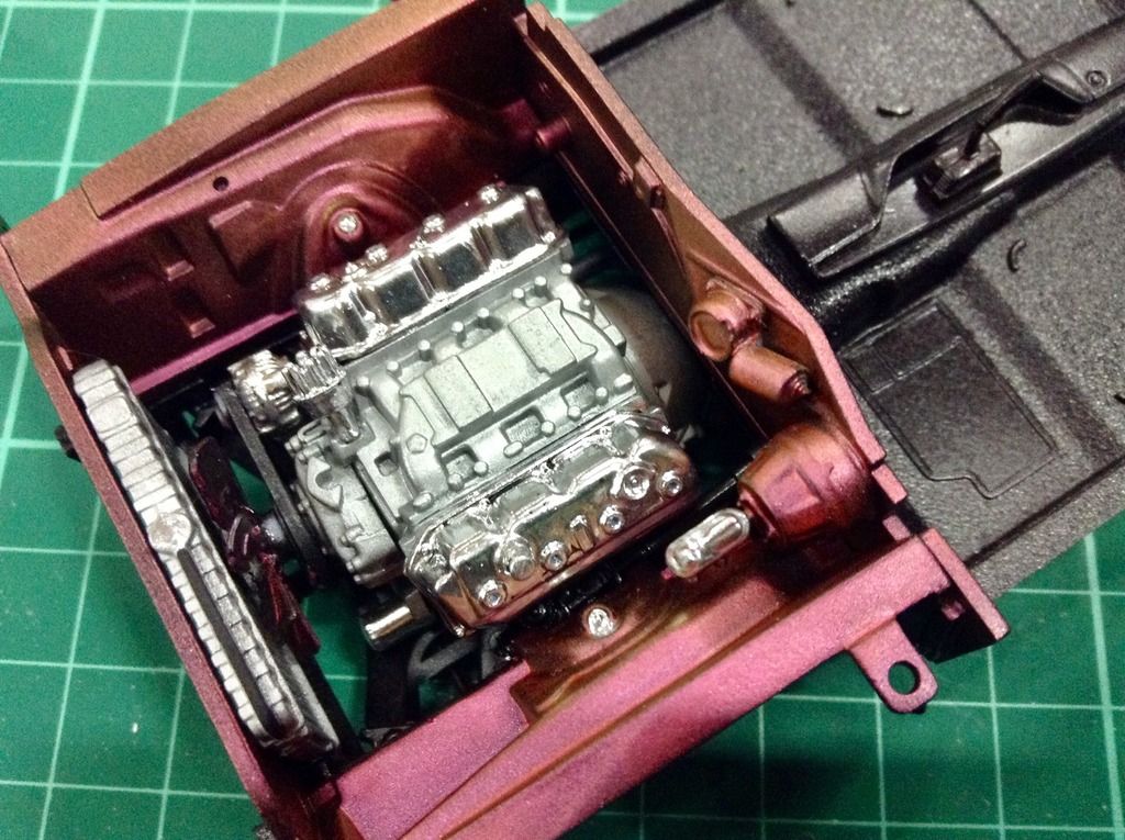

Ok there’s been a bit of movement on the Cuda but first here are some spoon tests of set 1. Oh I forgot to mention that the dropper bottles that come from Green stuff already have a shaker ball inside to aid mixing.
Again this is just gloss black primer, the paint and then a gloss coat, no clean up.

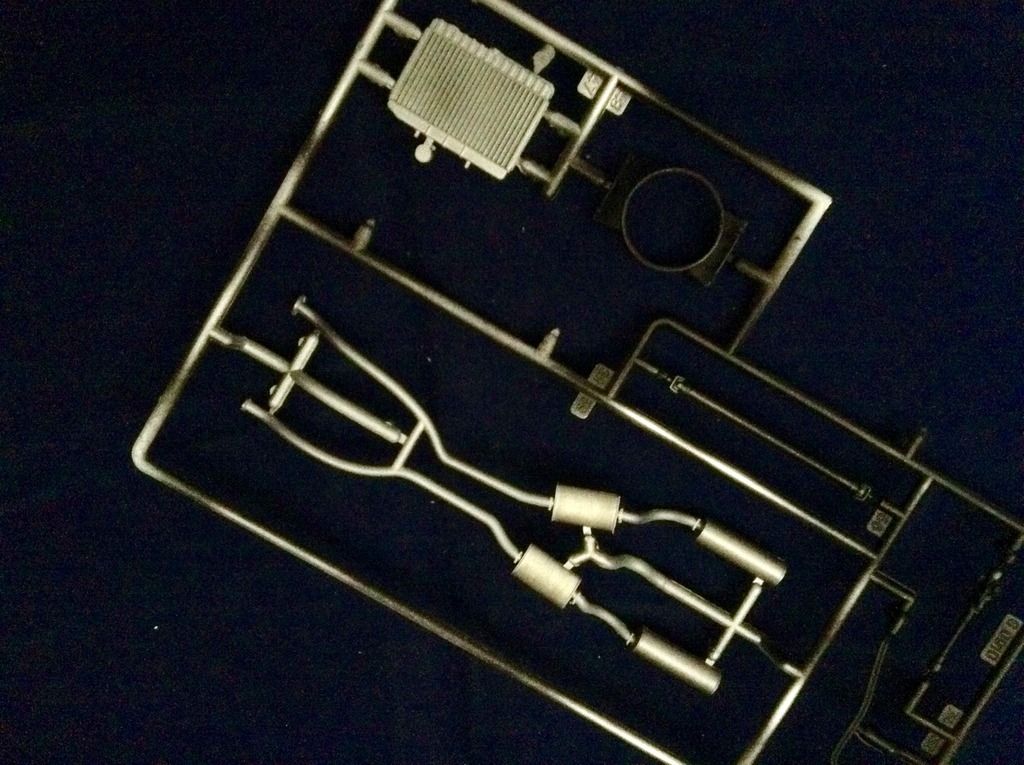

Now the Cuda and as you’ll see I have picked a colour! First exhaust in aluminium and stainless steel and the rad in aluminium also.
Now the engine painted aluminium with chrome silver intakes resting in the engine bay. Some detail work to do and an update at the end of the week as it’s back to work. The bonnet (hood) has also had a coat in this colour and I’ll see how it polish’s up, I have a spare bonnet hence using the bonnet before I hit the body.

Luciano,
The paint and colors are super impressive. And the test spoon gloss finishes are insane
All the metal paint work looks realistic both on the sprue tree and in the engine compartment.
Joel

The colours are spectacular! I've never had much luck with water-based metallics, but you've certainly inspired me to try these if I tackle a custom finish.

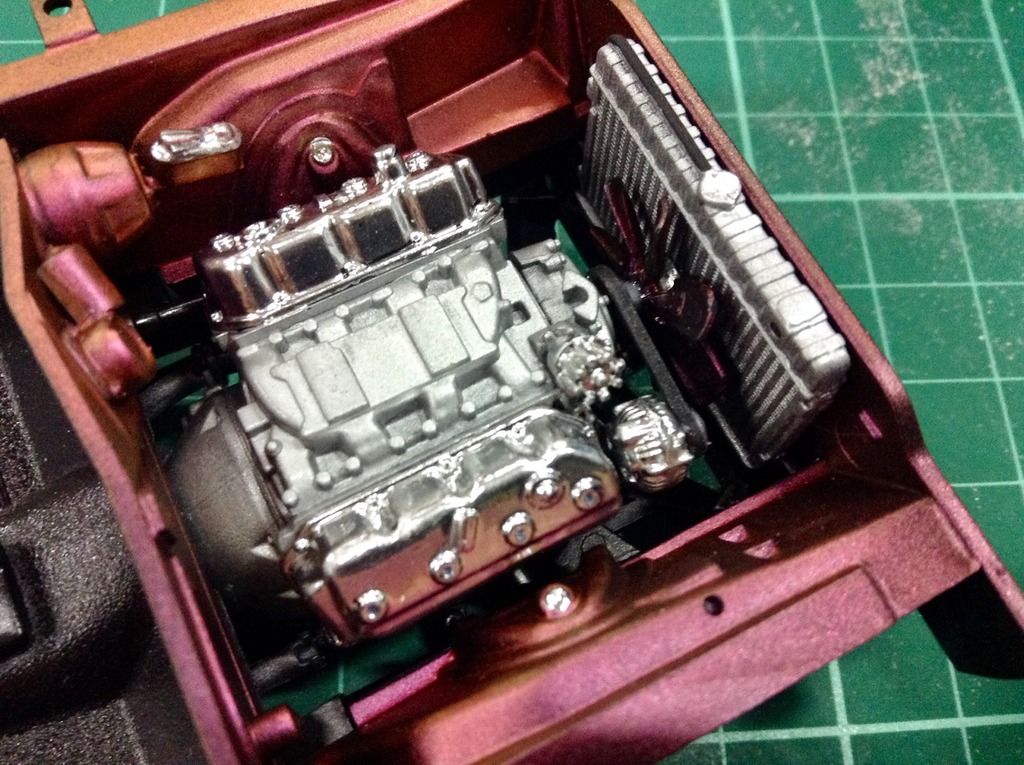

Joel, Rowan, thanks for your comments. I’m just back from a model show where I took the Cuda to work on while with my ‘local’ club stand. The intention was to pick up some coloured wire that one of the traders (venders for our US cousins) stocks only to find out he didn’t bring any with him!

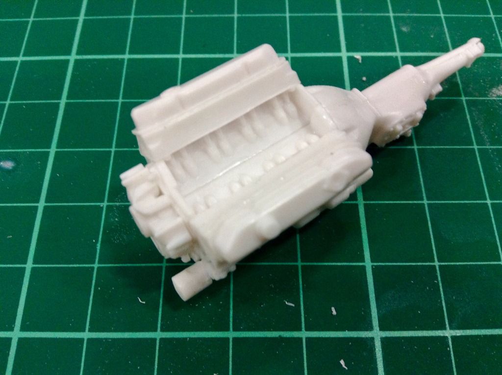

So drilled out the holes for the spark plug leads which I was going to pick up from the trader then started working on one of the kits I picked up.
Hemi Cuda engine with a little bit more progress:

Luciano,

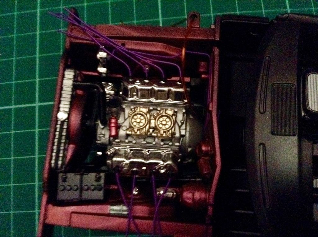

The Cuda engine compartment looks really good.
For my detailing wires, cables, and hoses, I use Detail Masters.
For the clear fuel lines I ordered them from Japan but it took forever, and with shipping was way to expensive. Some of my car buddies from another site suggested clear fishing line which is hollow. I found them at Bass Pro Shops and bought a few sizes, which worked just fine.
Joel

Yes I have some coloured wire already but was looking for different colours and thickness, I also have tinted clear tube for the fuel lines but need to get the carbs done first hence the Tamiya titanium gold paint in my postman post. I do need to see where the fuel line(s) go though as I haven't had a car with carbs since about 1990.
I should hopefully be able to get to the bench Monday and hope to complete the engine and bay. Hope to get the silver down on the body as well.

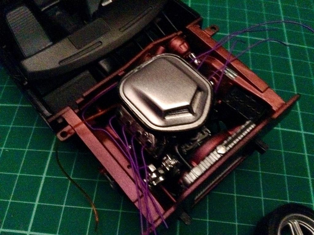

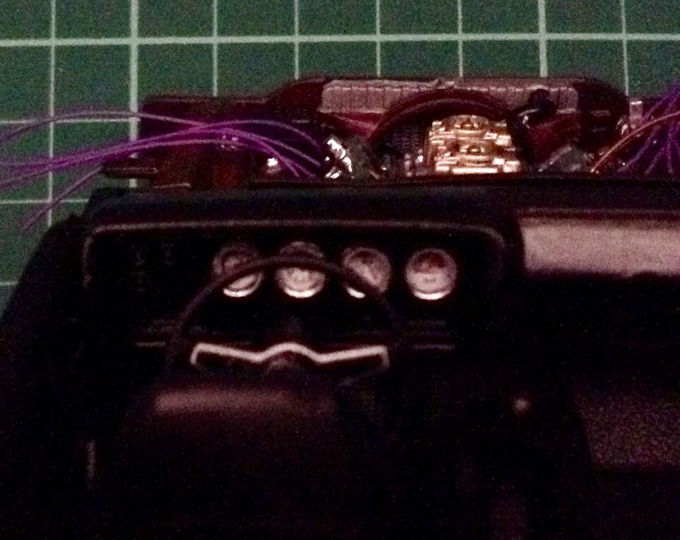

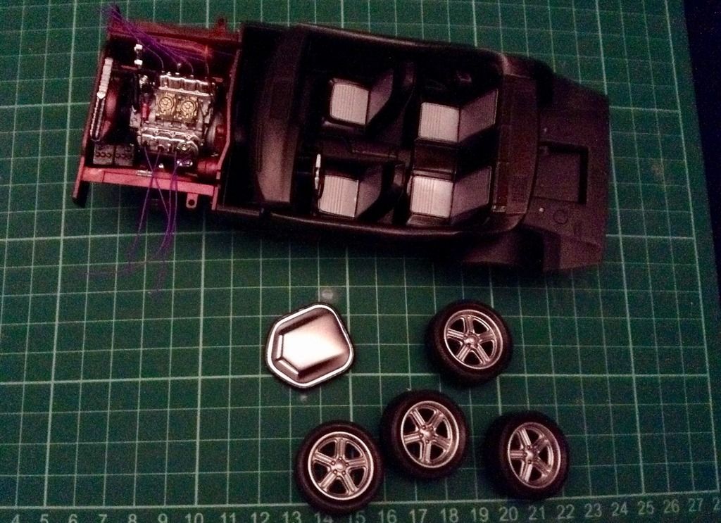

Well I got the Shine silver down on the body, this is the second coat after a small blob of paint came out the airbrush, that was left to dry then sanded back and polished out before the second coat, now the body sits in its dust shield box to cure.
Interior and engine plus shaker air intake and wheels.
The wheels were de-chromed sprayed gloss black then chrome silver. Carbs are painted and fitted plus drilled ready for the fuel lines (clear orange tube), spark plug leads are on the plugs but need to be loomed round and fitted to the distributor (purple leads).
Dials in the dash with the chrome surrounds painted using the Molotow chrome pens
And what will be seen once the shaker is in place

Looking good Luciano, lots of shiny going on and the paintwork looks super smooth. What are you taking the photos with, they are very dark?
Cheers, D
Cheers, D
Sorry D I’m using an iPod touch which then syncs with my iPad Air so I can edit and send the photo to Photobucket before posting. Although I do have a decent camera I have no way to get the photos onto the iPad. Why don’t I use the camera on the iPad? Well the iPod has a better camera and a flash but neither are very good at close up. Been thinking of upgrading to a new generation iPad which you can plug a usb cable into as mine is now rather old compared with what’s out there now.
Joel_W
AUTOMODELER
KitMaker: 9,667 posts
Posted: Wednesday, March 27, 2019 - 02:17 AM UTC
Lucaino,
The details are really making quite a difference especially the added lines to the engine.
One thing that will greatly help with the picture issues is add more light. I shoot even my grab shots with two Tensor lights and my Otto work light, and crank up the ISO to 800.
Joel
