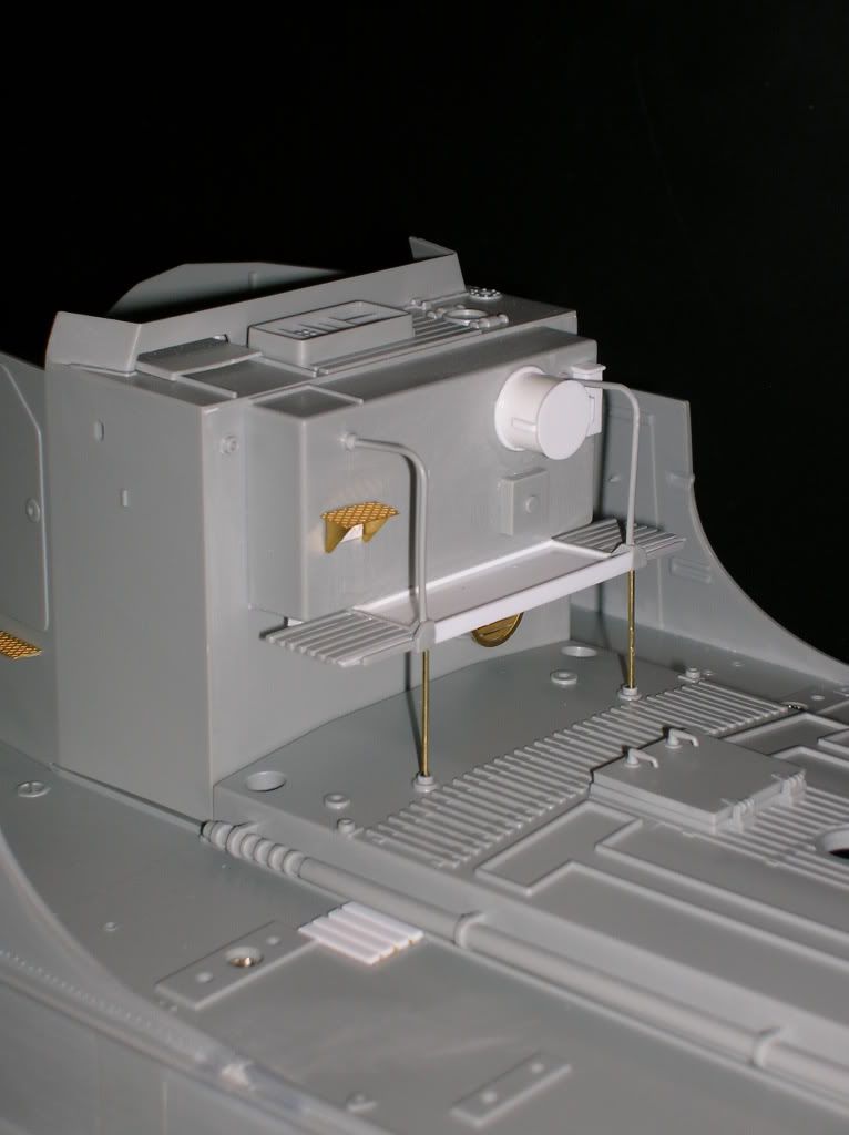

I am currently working on the S38 wheelhouse, here is a picture of the first draft, still many details that need to be added, but as a teaser it should do the trick.
bis denne
